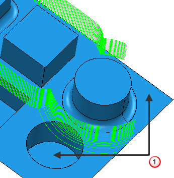

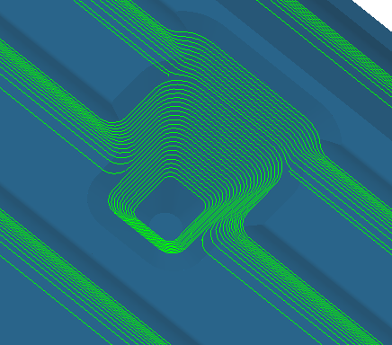

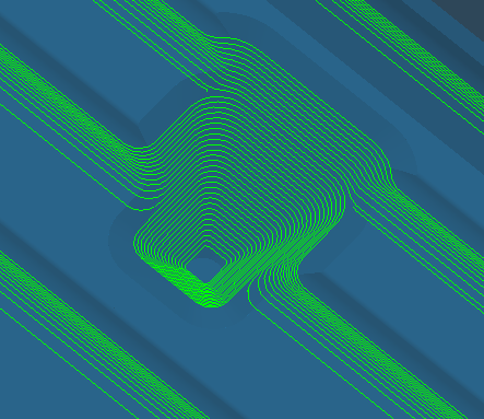

Only remove segments from enclosed areas — Select this option to remove segments, in enclosed areas, that are smaller than the Threshold value.
Areas where segments are removed as these segments are smaller than the Threshold value.
Areas where segments are not removed as these segments are not in an enclosed area even though they are smaller than the Threshold value.
