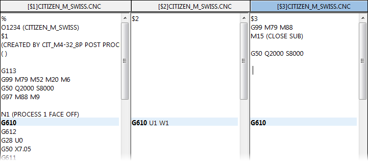

When a single NC Program file contains multiple channels, PartMaker recognizes the delimiters which denote the different channels. For example, the file below is split into three channels using the delimiters $1, $2, and $3:

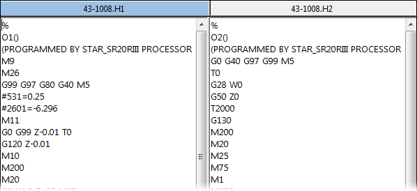

When multiple NC Program files each contain a separate channel, PartMaker shows each file in its own channel. For example, the two files below, H1 and H2, are each shown in their own channel:

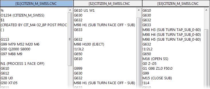

PartMaker can align the content in all the channels according to 'wait' and 'sync' codes.
To align the different channels, click :
Note: PartMaker aligns channels in the NC Program by matching identical 'wait' and 'sync' codes across the different channels. The majority of multi-channel machines for which PartMaker can provide Post Configuration files use this method of synchronization. However, if you are using a machine that synchronizes using other methods (for example, by matching pre-defined, non-identical wait codes), the Align button is unavailable.

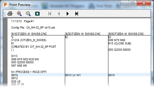

When the NC Program window displays aligned, multi-channel output, PartMaker also reflects this layout in printed output. For example:
