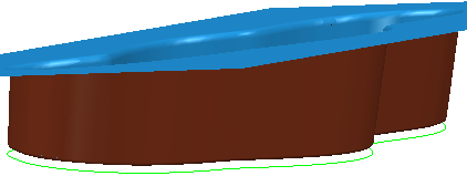

- Off — Select to create a single toolpath.

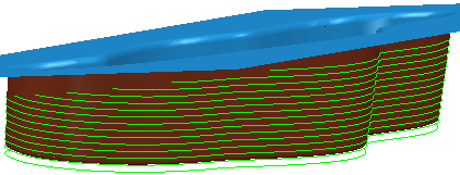

- Offset down — Select to offset the top cutting path, moving down.

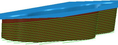

- Offset up — Select to offset the bottom cutting path, moving up.
