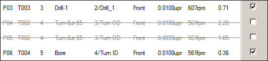

PartMaker uses a strikethrough to denote processes that are excluded from simulation and postprocessing. For example:
Tip: The Status column is displayed only if the Job Optimizer > Show Process Status menu option is selected.
