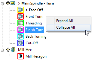

You can control how much information is displayed in the Job Explorer pane by expanding and collapsing items:
For example:
To expand or collapse all items, right-click in a blank area of the Job Explorer pane and select Expand All or Collapse All from the menu:

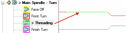

The currently selected items in the Job Explorer pane are displayed in the main PartMaker windows. These items are preceded by the > symbol and shown in bold. For example:

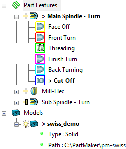

The Face window items are grouped beneath the
Part Features
item. Any solid, surface, or triangle models are grouped beneath the
Models
item.
To change the visibility of a model, click the light bulb beside the model. If the light bulb is on (), the model is visible in the Face window. If the light bulb is off (
), the model is not visible in the Face window. Hiding a model to make it easier to view and work on the remaining visible models.
When expanded, each model item displays the following information:
Type — The type of model. There are three possible types:
Path — The path of the file from which the model was imported.

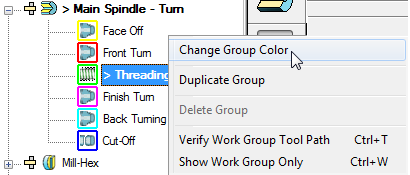

Right-click an item (or its icon) in the Job Explorer pane to display a list of menu options relevant to that item. For example:
Selecting the Change Group Color option displays the Color dialog, where you can select a new color for the group. PartMaker also uses the color you select to update the sample color in the Color Palette.
