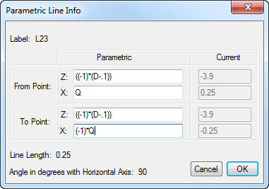

  4. Using PartMaker's CAD mode, double-click every geometry element ( Line, Arc, Circle) that might change depending on parameters in the Parameters files. PartMaker displays the Parametric Line Info, Parametric Arc Info or Parametric Circle Info dialogs for you to enter parametric definitions. For example:
    In PartMaker all Z dimensions are programmed as negative values. When performing mathematical operations on parameters, use parentheses, as show above. PartMaker uses the standard order of operations for multiplication, division, addition, subtraction and the application of trigonometric functions.
