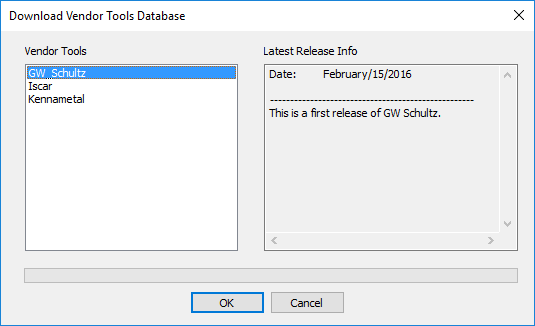

Download Vendor Tools Database dialog (PartMaker)
Use the Download Vendor Tools Database dialog to select the vendor master tools database that you want to download from the cloud. When you have downloaded a vendor master tools database, you can import the tools into your Tools Data (.tdb) file.
To display this dialog:
  1. On the Manage Tools Files dialog or Import Tool dialog, click the arrow beside the split button to display its menu.
  2. Select Download Vendor Master Tools Database.
All available vendor tool databases are displayed in the dialog window. Select a vendor name then click OK to download it.
Click Cancel to close the dialog without importing a database.
