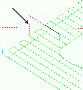

Using Toolpath Point with a Plunge Distance of 2 gives this result:
Using Previous Height with a Plunge Distance of 2 gives this result:
