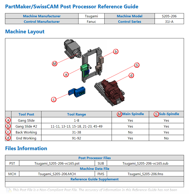

    PartMaker creates and displays the Post Processor Reference Guide. For example:
