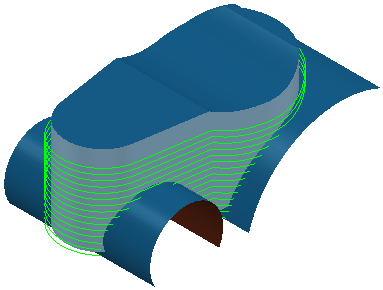

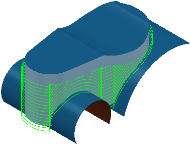

Mode —Select a mode to determine how the multiple passes are created.
- Off — Select to create a single toolpath.
- Offset down — Select to offset the top cutting path, moving down.
- Offset up — Select to offset the bottom cutting path, moving up.
- Merge — Select to offset the top and bottom cutting path, merging from one to the other.
