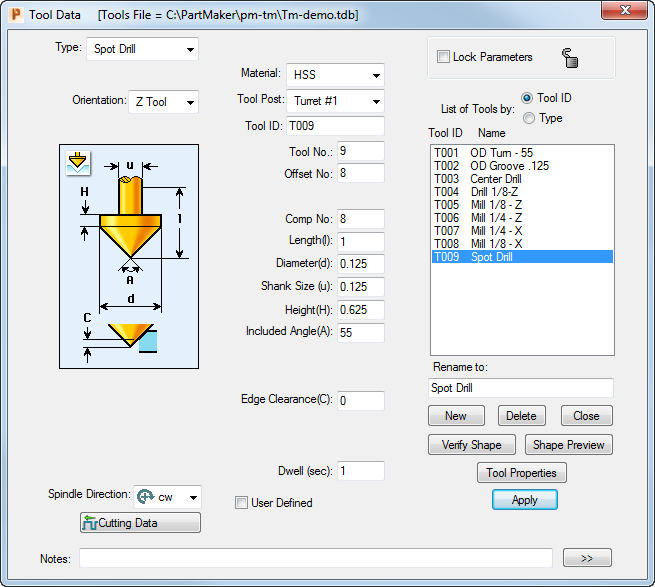

Spot Drill tool (PartMaker, Tool Data)
When a Spot Drill is selected, the Tool Data/Edit Tool dialog is the same as for the Chamfer tool, except that the Small Diameter field is not displayed for Spot Drill tools.
