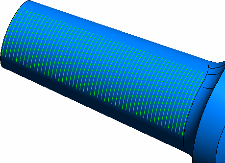

Use the Spine finishing page to project a tubular pattern onto the model, which is then machined. The curve that is used as the center of this tube (the focus of the pattern) is known as a Spine curve.

Style — Select a style to define the shape of the pattern.
