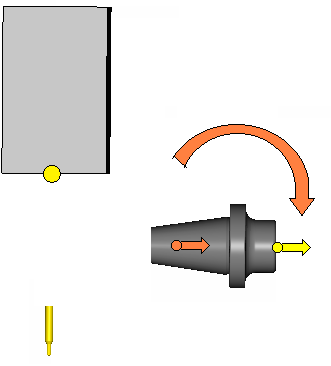

- The Holder is rotated so the Tool to Holder Attachment vector is along the negative Z axis:

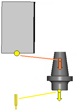

- The Holder to Tool Head Attachment Point is positioned to the Tool Head's origin, then the Tool is positioned to the Tool to Holder Attachment Point:

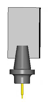

- The final result is shown below:
