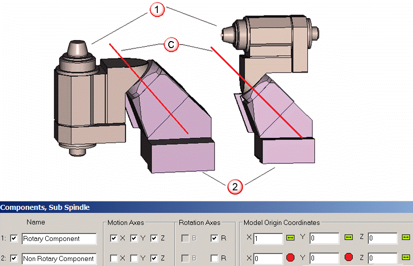

- 45 Degree Line in ZX Plane — Select to specify that the sub-spindle rotates about an axis that is inclined at 45 degrees in the ZX plane.
The rotary component moves when the sub-spindle rotates for part transfer and always moves in the X, Y and Z axis.
The non-rotary component does not rotate. Its motion axis can be restricted in the X, Y and/or Z axis.
The rotary axis rotates 180 degrees about an inclined axis.
