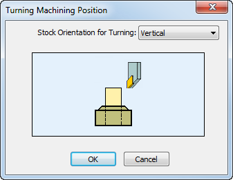

Turning Machining Position dialog (PartMaker)
In PartMaker/Mill, you can use the Turning Machining Position dialog to change the orientation of the stock for turning operations when you are using a Rotary 5 Axis table.

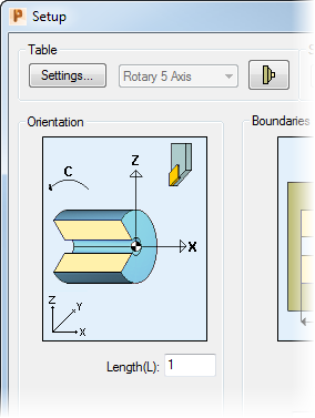

To display this dialog, click the button in the Table area of the Setup dialog. This button is only available when you have the following:
If you change the orientation from vertical to horizontal, the graphic in the Orientation area of the Setup dialog is updated, and the button changes from to .
Vertical stock orientation
Horizontal stock orientation
If you select a Horizontal stock rotation, the New Hole Group button on the CAM window toolbar is unavailable.
