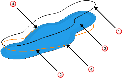

All the toolpaths are generated using:
— top pattern
— bottom pattern
— limiting surface
— intersection of the bottom pattern with the limiting surface

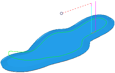

Lift tries to machine at the lowest position. If it can't machine at the lowest position the toolpath segments are removed.

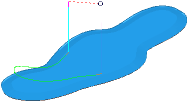

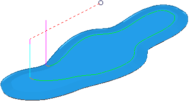

Trace tries to machine at the lowest position. If it can't machine at the lowest position the toolpath is raised as little as possible until it reaches a position at which it can machine. It will only raise the toolpath to a position defined in the Upper limit field. If you do not specify an upper limit then an infinite upper limit is assumed.
Upper limit of None:
Upper limit of Top, and an Offset of -12:
