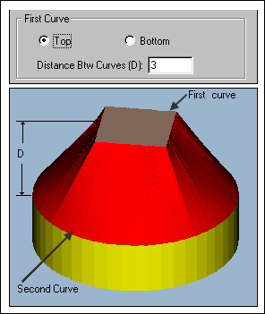

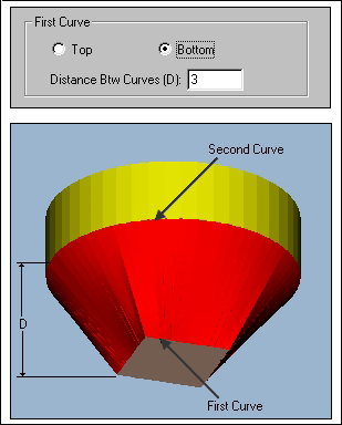

First Curve
- Top — Select this option if the first curve is on the top. If the First Curve is on Top, and the Distance Btw Curves (D) is smaller than the height of the part, then the land is on the bottom of the part.
- Bottom — Select this option if the first curve is on the bottom. If the First Curve is on Bottom, and the Distance Btw Curves (D) is smaller than the height of the part, then the land is on the top of the part.
- Distance Btw Curves (D) — Enter the distance between curves.
