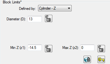

When using the Define Block dialog to define a block using Cylinder -Z, you can choose to:
Block limits — Use these settings to specify the extents of the block.
Diameter — Enter the diameter of the circle that defines the cylinder.
Min Z and Max Z — Enter the minimum and maximum Z values of the cylindrical block.
Locking block limits
You can lock specific values to prevent them from being changed while adjusting the model limits.
Unlocked — When displayed, you can edit the value.
Locked — When displayed, you cannot edit the value. If you try to re-calculate the Block Limits by entering a specific or Expansion value, the Locked values remain unchanged.
Click the button to toggle between Locked and Unlocked .
Lock all limits — Click this button to lock all the unlocked parameters.
Unlock all limits — Click this button to unlock all the locked parameters.
