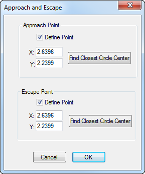

Use the
Approach and Escape
dialog to specify approach and/or escape points for a toolpath.
To display the dialog, either:
The following settings are available:
Approach Point
- Define Point
— Select this option to include an approach point in the toolpath.
- X — Enter the X coordinate of the approach point.
- Y
— Enter the Y coordinate of the approach point.
- Find Closest Circle Center
— Click to assign the coordinates of the closest circle center to the approach point( X,Y) coordinates.
Escape Point
- Define Point
— Select this option if you want
PartMaker to include an escape point in the toolpath.
- X
— Enter the X coordinate of the escape point.
- Y
— Enter the Y coordinate of the escape point.
— Click to assign the coordinates of the closest circle center to the escape ( X,Y) coordinates.
OK
— Click to save any changes and close the dialog.
Cancel
— Click to close the dialog without saving any changes.
