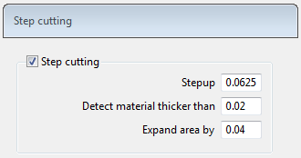

Step cutting — Select to enable step cutting.
Step up — Enter the distance between intermediate cutting levels.
Stepdown of the main slice.
Stepup of the intermediate slice.
The main slice clears the majority of the material. The intermediate slices remove the terraces remaining after the main slice.
Detect material thicker than — Enter a threshold value. PartMaker ignores rest material that is thinner than the specified threshold. This helps to avoid thin regions being rest machined, where the benefit of a second cut is negligible. These thin regions can be caused by cusps from the previous toolpath.
Expand area by — Enter the distance by which to expand the rest areas, measured along the surface. Use with the Detect material thicker than value to reduce the areas to be machined to the details (for examples, corners), and then to offset these areas slightly to ensure that all the detail (for example, on the corners) is machined.
