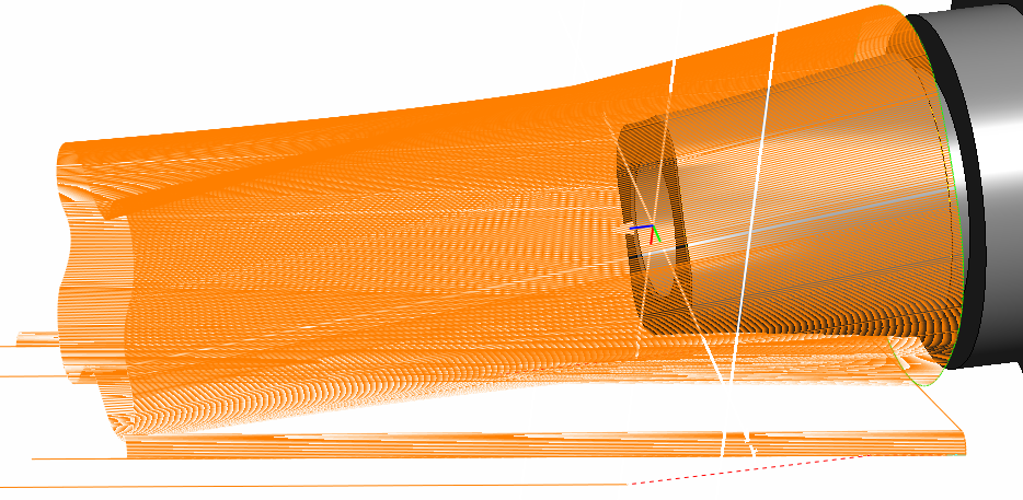

Show Tool Axes — Shows or hides the tool axes for a toolpath that has been verified.
Use this menu option to display the tool axes for 4- or 5-axis simultaneous toolpaths or toolpaths imported from a PowerMill project.
When this menu option is selected, PartMaker displays the tool axes on the solid model. For example:
Tip: You can select the color used to display the tool axes on the Solids Options dialog.
This option is also available on the Solids Windows toolbar.
Note: Only applicable for 4- or 5-axis simultaneous toolpaths or toolpaths imported from a PowerMill project.
