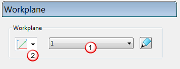

Create and manage setups for each machining operation. Specify a workplane common for all toolpaths in a setup, and specify the stock geometry.
