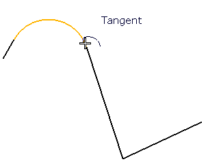

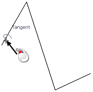

- Click on the first position to define the start tangent of the curve.
If the cursor is moved over a wireframe object and the intelligent cursor is switched on, the word 'Tangent' is displayed where tangency is defined, otherwise (for example, if 'End' is displayed) the program assumes a start point is being specified.

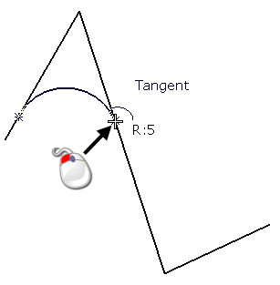

- Click the second position to define the end tangent of the curve where the blend must be defined.
- The new fillet curve is created and the objects are trimmed. It is a two point Bézier curve.
