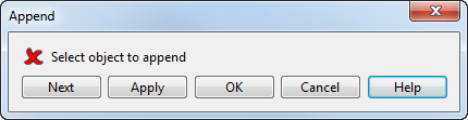

The
next to
Select object to append changes to
By default, the ends of the objects nearest to each other are appended. If the two ends don't touch, they are joined by a span. The tangency at the ends of the new span matches the ends of the existing objects:
As you click Next, the other solutions are displayed on the screen.
