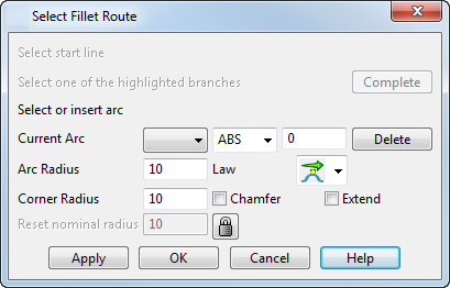

Use this dialog to:
- select the fillet routes.
- control the shape of the fillet.

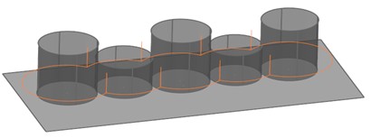

When this dialog is displayed, candidate lines display to help you determine the fillet route.
Note: The candidate lines are the spines of the possible fillets. These lines are selected to create fillets to your requirements.
