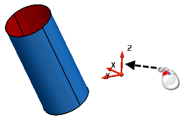

You can use the principal plane of any workplane as a cutting object. The workplane does not have to be active.
- Select any workplane as the cutting object.
- Click Edit tab > Limit panel > Selection to display the Limit selection toolbar.

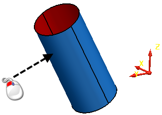

- Select the objects you want to limit to the principal plane, which in this case is the XY plane.
The object is trimmed to the principal plane.
- If the solution is not what you expected, click the Next Solution button
until you see the required solution. Note: Next Solution cycles through the possible solutions.
