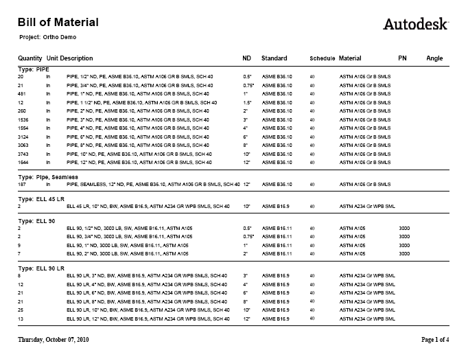

Produces a Plant 3D bill of materials. See the sample report below.

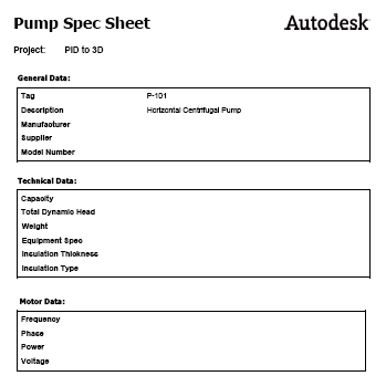

Produces a P&ID spec sheet. See the sample report below.

Here are two sample reports, the first is the 3D parts imperial and the second a P&D spec sheet, both in PDF format.
