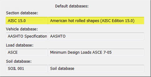

Steel Section Databases
The new steel section database AISC 15th Edition has been added.
By default, this new section database is selected.
To choose the former databases:
  1. Click Tools Job Preferences Databases.
    The Job Preferences dialog opens.
  2. Select Steel and timber sections in the left panel of the Job Preferences dialog.
  3. Click to add a section database.
    The Declaring Section Database dialog opens.
  4. Click Browse, and select the appropriate file.
    File Section Database
    Aisc2pro.xml 13.2
    Aisc3pro.xml 14.0
    Aiscpro.xml 15.0
