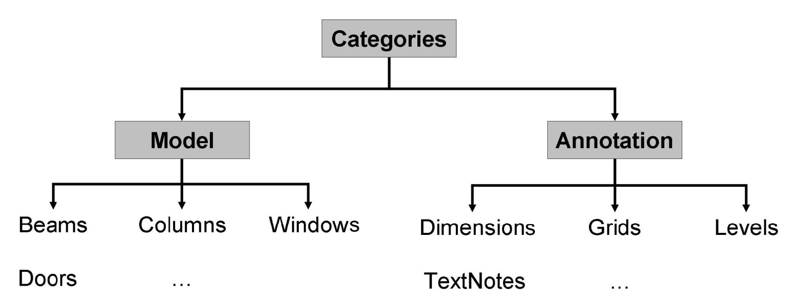

Categories are the most general class. The Document.Settings.Categories property is a map that contains all Category objects in the document and is subdivided into the following:
Figure 20: Categories

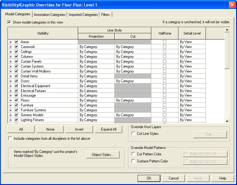

  • Categories are also used for controlling visibility and graphical appearance in Revit.
Figure 21: Visibility by Category

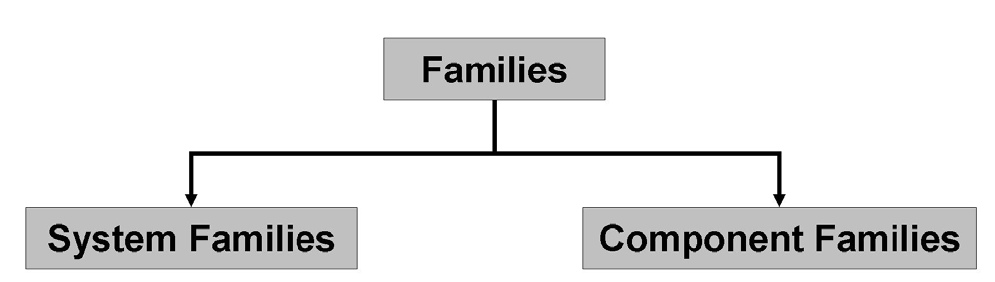

Most families are component Family files, meaning that you can load them into your project or create them from Family templates. You determine the property set and the Family graphical representation.
Another family type is the system Family. System Families are not available for loading or creating. Revit predefines the system Family properties and graphical representation; they include walls, dimensions, roofs, floors (or slabs), and levels.
Figure 22: Families
