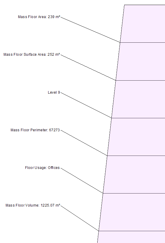

To display other parameter values in a mass floor tag, create a tag family that include the desired information, as shown.
Sample tags for mass floors
