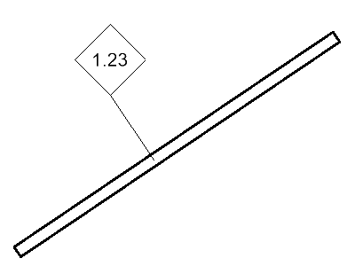

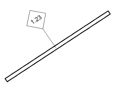

Rotate with component enabled. |
Rotate with component disabled. |
