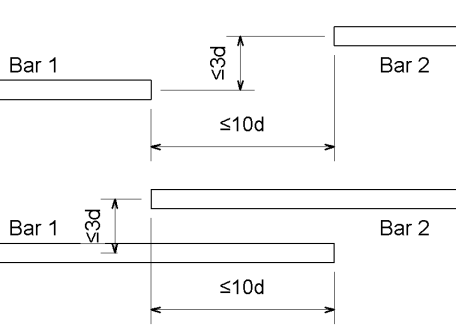

      For a coupler to connect two rebar instances, the connected ends must be no more than the distance of 10 bar diameters apart. The bars cannot be offset more than 3 bar diameters from one another.
      Coupler placement tolerance
