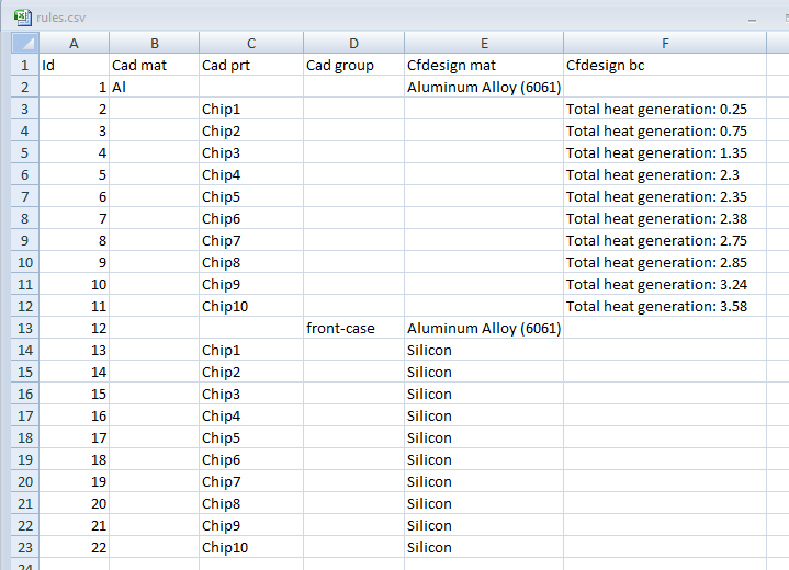

Here is an example of a template created in Excel:
In this example, the table simplifies assigning the heat load and material to the chips. The rules are similar enough that simply copying and pasting the rows nearly completes the definition. To finish, simply modify the heat generation for each chip in the table.
