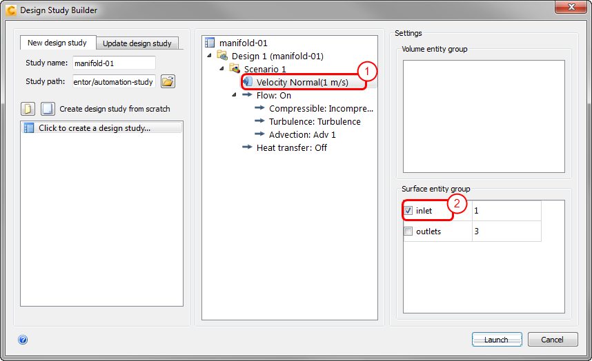

For example, to determine the optimal heat sink placement in a lighting assembly, an engineer creates several designs with the instance management tool of the CAD system. The designs are similar and will use the same analysis settings and materials. He uses the Design Study Builder to create a design for each CAD design, and assigns setting to CAD objects. The engineer then launches the completely defined design study into Autodesk® CFD, and runs the scenarios.

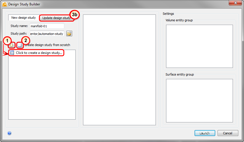

There are three ways to define the design study:
To define all settings, click the New icon, and Click to create a design study....
To use a Template, click the Template icon. Browse, and select from the list.
Add a design to an existing design study:
Create a new design variation in your CAD system. Open the Design Study Builder.
Click Update design study, and select the design study to modify.

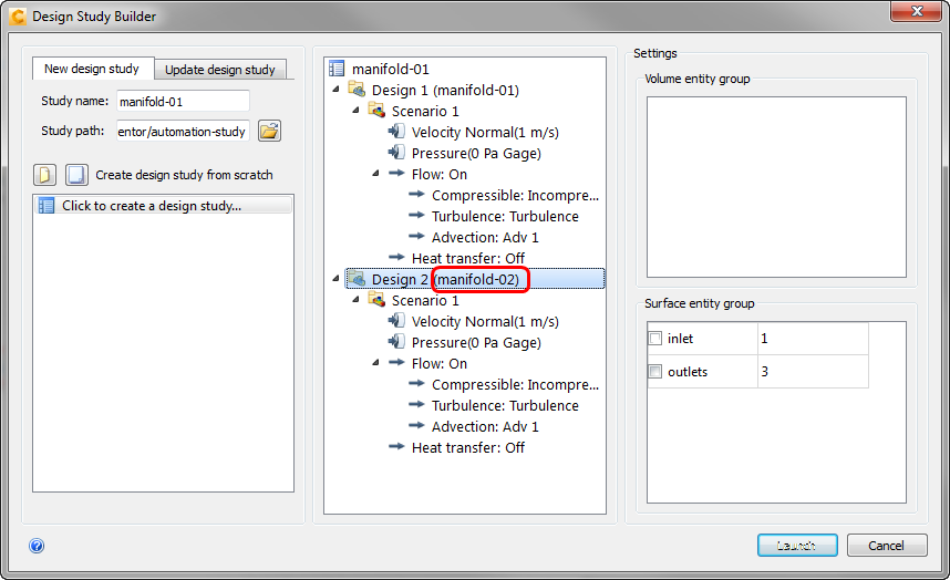

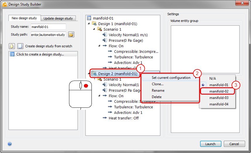

Clone a design in the Design Study Builder, and associate the new CAD design with the cloned design (as described below).
This is an alternative way to add a design to an existing design study. Unlike the Design Study Manager, this method does not require cloning in Autodesk® CFD prior to returning to the CAD system.
To copy a design or scenario, right click on the item, and click Clone.
The CAD design name appears beside the design name in the tree:
