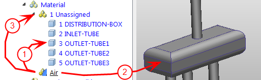

Do one of the following to assign a material:
Drag the material onto the part branch in the Design Study bar.
Drag the material onto the part in the model.
Drag the material onto another material branch (or Unassigned). This assigns the material to all parts below it.
For an example of applying materials...

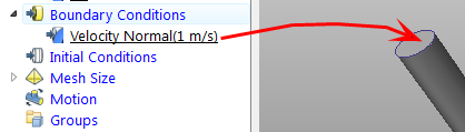

To assign a boundary condition, drag the condition onto the part or surface:
For an example of applying boundary conditions...
