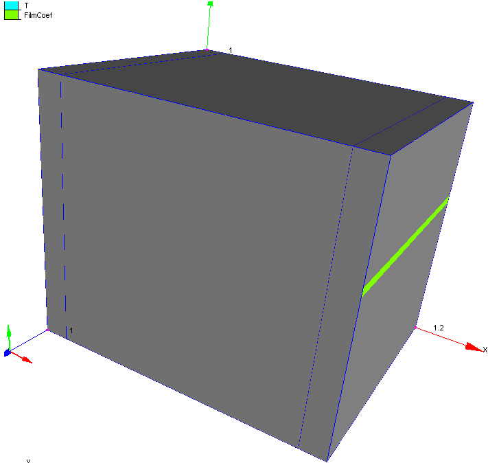

This model uses two solid planes separated by a 1 meter fluid space. Both planes are 0.1 meters thick.
The heat transfer by radiation is calculated as:
This should balance with the heat transfer by convection from plate 2:
Geometry and Boundary Conditions
The thermal loads include a specified temperature of 333 Kelvin on the outside surface of one plate. On the outside surface of the other plate, a wall film coefficient of 1.0 and an ambient temperature of 273 Kelvin is applied.
