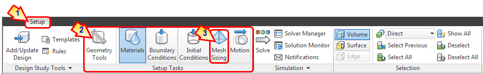

Each ribbon follows a simple hierarchal structure:
Throughout the Autodesk® CFD Help topics, procedures refer to specific commands from the ribbon. To ensure clarity, each reference consists of the tab name, followed by the panel name, followed by the command name (Tab > Panel > Command).
For example, this is the reference to the Solver Manager command in the Simulation panel of the Setup tab:
Setup (tab) > Simulation (panel) > Solver Manager.
