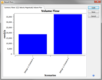

Select a row by clicking on the result quantity in the Summary Value table. To select multiple rows, hold the ctrl key while selecting rows. Use Plot Selected Rows to create a bar-chart of the result quantities for all selected scenarios:
Create a plot showing all result quantities listed in the Summary Value table. Each quantity is displayed on a separate tab.
