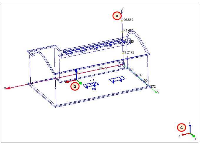

Expand the Axes menu to toggle the display of the three coordinate axes:
a. Bounding Coordinate Axis
b. Local Coordinate Axis
c. Global Axis
The value in the adjacent field is the number of axis increments. Change this number with the arrows to the right of the field.

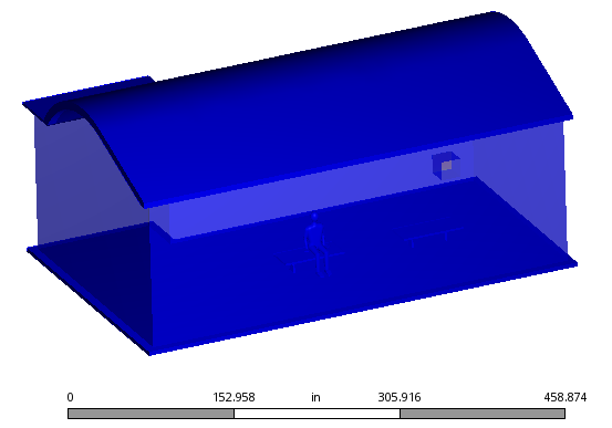

Toggle the display of the model scale. This is useful for understanding the physical length of the model.

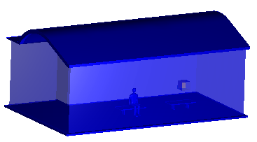

Toggle between Orthographic and Perspective to control the depth view of the model.
Orthographic:
| Perspective: ![]() |
Orthographic displays model entities in their actual sizes. It is useful for making selections when the model is aligned to a Cartesian axis.
Perspective provides "depth" to the model by reducing the size of objects that are further away from the viewer. It provides a more physically realistic view.
Example showing the use of the Orthographic view...
