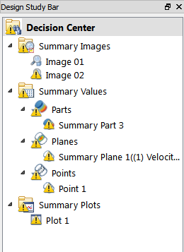

Summary Items are images, planes, XY plots, parts, or points that are created in one scenario and automatically mapped across other scenarios in the design study. Each type of Summary Item is created with a unique command:
To compare an image from multiple scenarios:
Create a Summary Image with this icon:
Autodesk® CFD automatically captures the same image in the other scenarios in the design study.
To compare numerical results on planes or parts:
Create Summary Planes or Summary Parts with this icon:
After capturing a Summary Part or Plane in one scenario, Autodesk® CFD automatically captures the corresponding data from the other scenarios in the design study.

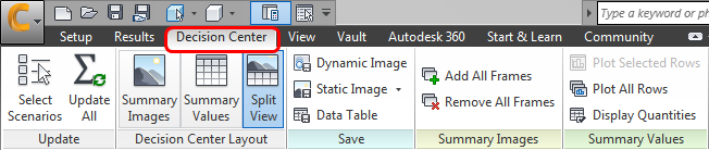

After capturing Summary items, compare them in the Decision Center. To open the Decision Center, click the Decision Center tab:
The Decision Center appears in the Design Study Bar:

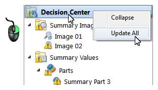

The following symbol means that a Summary item either has not been mapped to the other scenarios or that the results have changed since the last time it was mapped:
To update the Summary item, click Update All from the Decision Center tab:
Alternatively, right click on Decision Center, and click Update all:
You can update individual Summary items by right clicking on them and selecting the update command.

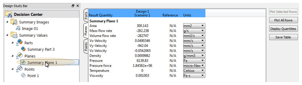

Use Summary Values to compare data from Summary Planes, Summary Points, and Summary Parts. To view the Summary Values table, click on a summary entity in the Decision Center.

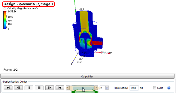

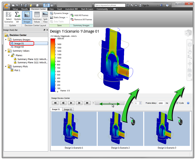

Use the Design Review Center to compare visual data with captured Summary Images. Click the image name in the Decision Center, and the image for each scenario appears in a separate thumbnail image in the Output bar. To add a thumbnail view to the display, drag it into the graphics window.
To view multiple images, drag the slider or use the "VCR" controls to flip between each design or scenario:
You can also divide the model screen into multiple viewports to compare results side-by-side:
