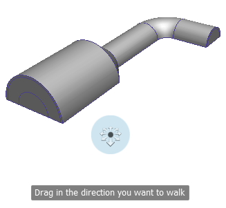

With the Walk command, you can navigate through a model as if you were walking through it. After you start Walk, the Center Circle icon displays near the center of the view. The cursor display changes to a series of arrows. To walk through the model, drag in any direction.
