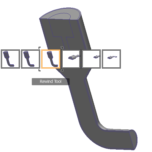

Use Rewind to revert to previous views saved to the navigation history as you reorient the model.
The navigation history holds a representation of the previous views of the model, along with a thumbnail image. A separate navigation history is maintained for each window, until you close the window. Rewind navigation history is view-specific, and is not saved between sessions.
On the wheel, click Rewind and hold to display the Rewind History panel. Then scroll through the views in the navigation history. To restore a previous view, drag the bracket to the left in the Rewind History panel.
