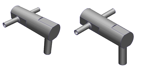

The following shows the same model viewed from the same viewing direction, but with different view projections. The image on the left is with Perspective enabled; the image on the right has Orthographic enabled.
