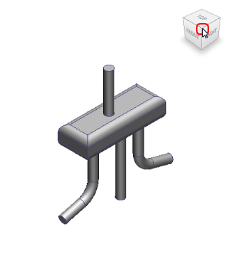

Click one of the faces, edges, or corners on the ViewCube.
You can also click and drag the ViewCube to reorient the view of a model to a custom viewpoint other than one of the twenty-six predefined viewpoints. As you drag, the mouse pointer changes to indicate that you are reorienting the current view of the model. If you drag the ViewCube close to one of the preset orientations, and it is set to snap to the closest view, the ViewCube rotates to the closest preset orientation.
The outline of the ViewCube indicates the current orientation type: freeform or constrained. When the ViewCube is in a freeform orientation, not orientated to one of the twenty-six pre-defined views, its has a dashed outline. When the ViewCube is constrained to one of the pre-defined views, its outlined is a solid continuous line.

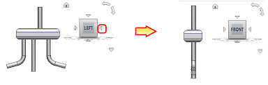

While viewing a model from one of the face views, four orthogonal triangles are displayed near the ViewCube. To rotate to an adjacent face view, click one of these triangles.

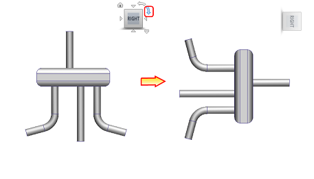

When you view a model from one of the face views, two roll arrow buttons appear near the ViewCube. Use the roll arrows to rotate the current view 90 degrees clockwise or counterclockwise around the center of the view.
