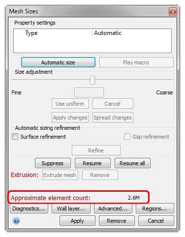

8. To determine if the mesh needs to be modified, check the Approximate Element Count. Right click off the model, and click Edit... Note the element count.
element count

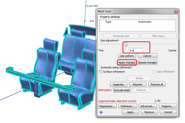

10. Select the two volumes of air in the ducts. In the Mesh Sizes dialog, drag the Size adjustment slider to approximately 0.6. Click Apply changes.
adjust size

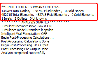

16. Scroll up in the Output Bar to note the final Element Count.
mesh view 1
mesh view 2
final mesh count
