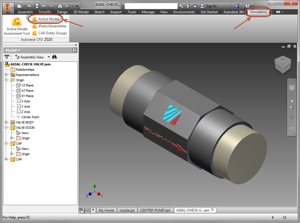

Step 2: Launch the Model
Click the command to launch the Active Model.
For example, if you are launching from Autodesk® Inventor, click Simulation and Active Model:
launch from inventor
