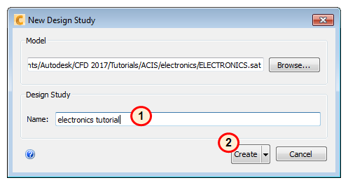

Step 3: Create the Design Study
  1. Enter a Name for the new design study. This can be anything you want.
  2. Make sure Create is the active option on the button, and click Create.
    design study dialog
    Autodesk® CFD starts, and creates the Design Study for the tutorial.
