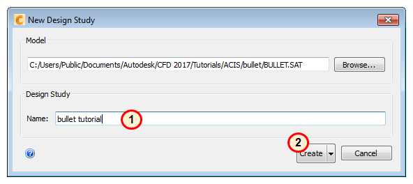

Step 3: Create the Design Study
  1. Enter a Name for the new design study. This can be anything you want.
  2. Make sure that Create is the active option on the button, and click Create.
new design study
Autodesk® CFD starts, and creates the Design Study for the tutorial.
