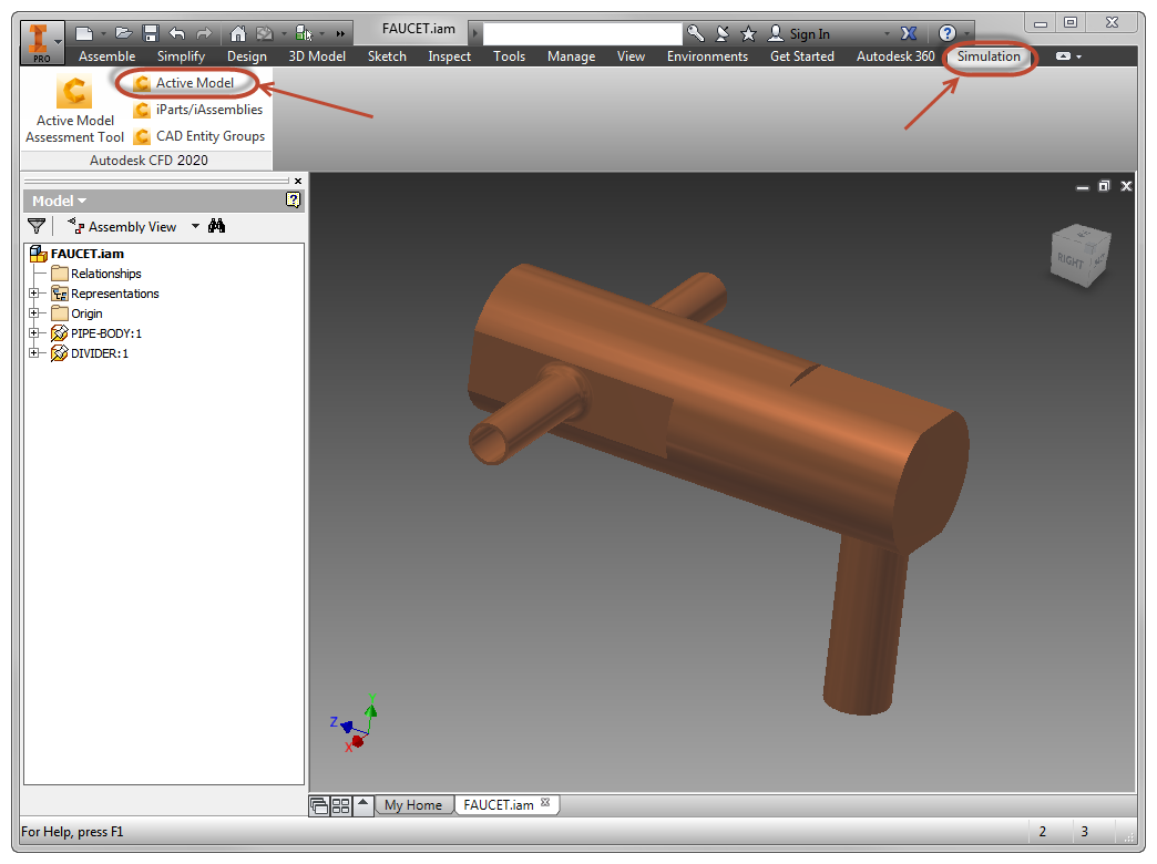

Step 2: Launch the Model
Click the command to launch the Active Model.
For example, if you are launching from Autodesk® Inventor, click Simulation and Active Model:
launch faucet
Step 3: Create the Design Study
The Design Study Manager dialog opens. For the tutorial, leave the Study name, Design name, Scenario name, and Study path as the defaults.
Click Launch.
Autodesk® CFD starts, and creates the Design Study for the tutorial.
