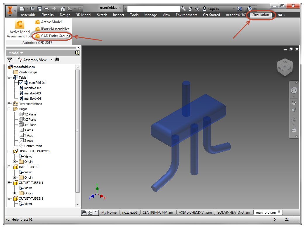

Click the CAD Entity Groups command.
For example, if you are launching from Autodesk® Inventor, click Simulation and CAD Entity Groups:
launch inventor

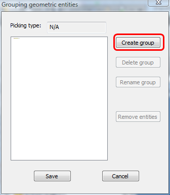

Click Create group.
create group

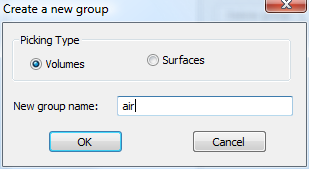

Select Volumes. Enter "Air" for the group name.
select volumes
Click OK.

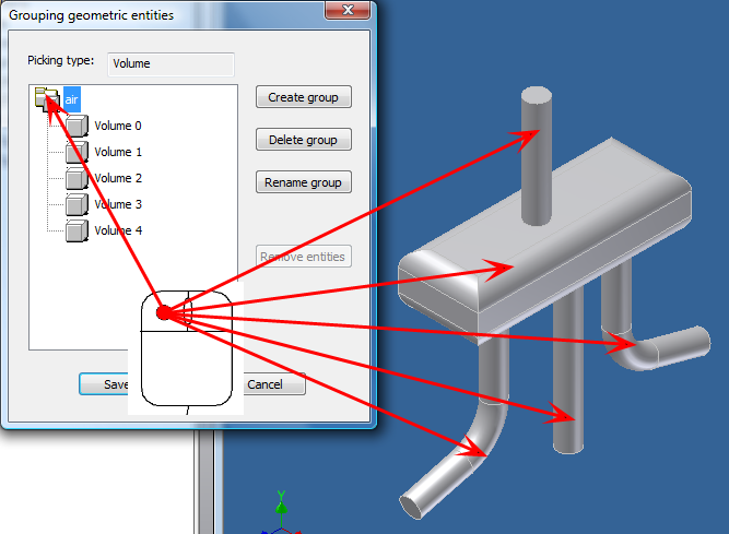

Click the air group, and select the five parts in the model.
air group

Note: We placed all the parts into the same group because they all have the same material. If one or more parts were to be assigned a different material, they should be added to a different group.
